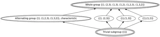

The subgroup structure of $S_3$ is described here, including this somewhat Enterprise-esque diagram:
subgroup structure of S_3
Let's denote the subgroups by $S_3$, $A_3$, $T_1$, $T_2$, $T_3$ and $I$ (from top to bottom and from left to right). Using the superset relation $\supseteq$ as the partial order $\le$, we can find the required values of the Möbius function using Aigner's Proposition $5.4$:
$$\mu(a,a)=1\;,$$
$$ \mu(a,b)=-\sum_{a\le z\lt b}\mu(a,z)\;, $$
and thus
\begin{eqnarray*} \mu(S_3,S_3)&=&1\;,\\ \mu(S_3,A_3)&=&-1\;,\\ \mu(S_3,T_i)&=&-1\;,\\ \mu(S_3,I)&=&3\;. \end{eqnarray*}
If we denote the probability for the subgroup generated by $m$ random elements to be contained in $H$ by $f_m(H)$ and the probability for that subgroup to be exactly $H$ by $g_m(H)$, then
$$ f_m(H)=\sum_{K\subseteq H}g_m(K)\;, $$
so we can use Möbius inversion from above (Aigner's Theorem $5.5$ (ii)) to obtain
$$ g_m(H)=\sum_{K\subseteq H}\mu(H,K)f_m(K) $$
and thus in particular
$$ g_m(S_3)=\sum_{K\subseteq S_3}\mu(S_3,K)f_m(K)\;. $$
With
$$f_m(K)=\left(\frac{|K|}{|S_3|}\right)^m\;,$$
this becomes
$$g_m(S_3)=1-2^{-m}-3\cdot3^{-m}+3\cdot6^{-m}\;.$$
We can check this against a direct calculation for $m=2$, where we have to draw either a transposition and a $3$-cycle or two different transpositions to generate all of $S_3$, with probability
$$ 2\cdot\frac36\cdot\frac26+\frac36\cdot\frac26=\frac12\;, $$
and indeed
$$g_2(S_3)=1-2^{-2}-3\cdot3^{-2}+3\cdot6^{-2}=\frac12\;.$$

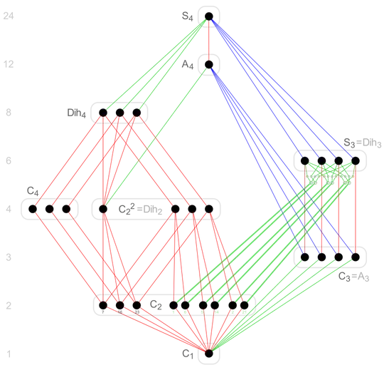

The subgroup structure of $S_4$ is analyzed here, including this amazing diagram:
(Attribution for the diagram: By Watchduck (a.k.a. Tilman Piesk) - Own work, CC BY-SA 4.0, Link).
Using the diagram's labels for the types of subgroups (but with $D_4$ instead of $\text{Dih}_4$) and distinguishing the left-hand and right-hand types of $C_2^2$ and $C_2$ groups in the diagram by $L$ and $R$, respectively, we find as above:
\begin{eqnarray*} \mu(S_4,S_4)&=&1\;,\\ \mu(S_4,A_4)&=&-1\;,\\ \mu(S_4,D_4)&=&-1\;,\\ \mu(S_4,S_3)&=&-1\;,\\ \mu(S_4,C_4)&=&0\;,\\ \mu(S_4,C_2^{2L})&=&3\;,\\ \mu(S_4,C_2^{2R})&=&0\;,\\ \mu(S_4,C_3)&=&1\;,\\ \mu(S_4,C_2^L)&=&0\;,\\ \mu(S_4,C_2^R)&=&2\;,\\ \mu(S_4,C_1)&=&-12\;.\\ \end{eqnarray*}
Then Möbius inversion from above yields
$$ g_m(S_4)=1-2^{-m}-3\cdot3^{-m}-4\cdot4^{-m}+3\cdot6^{-m}+4\cdot8^{-m}+12\cdot12^{-m}-12\cdot24^{-m}\;. $$
Again we can check the case $m=2$ by hand. The following pairs of elements of $S_4$ generate all of $S_4$: each one of $6$ transpositions with one of $4$ $3$-cycles or with one of $4$ $4$-cycles, each one of $8$ $3$-cycles with any one of $6$ $4$-cycles, and each one of $6$ $4$-cycles with one of $4$ $4$-cycles, for a probability of
$$ \frac{2\cdot6\cdot4+2\cdot6\cdot4+2\cdot8\cdot6+6\cdot4}{24^2}=\frac38\;, $$
and indeed
$$ g_2(S_4)=1-2^{-2}-3\cdot3^{-2}-4\cdot4^{-2}+3\cdot6^{-2}+4\cdot8^{-2}+12\cdot12^{-2}-12\cdot24^{-2}=\frac38\;. $$
For $m\to\infty$, the leading term will always be the one corresponding to $A_n$, so the probability not to generate all of $S_n$ is asymptotic to $2^{-m}$ for all $n$.
