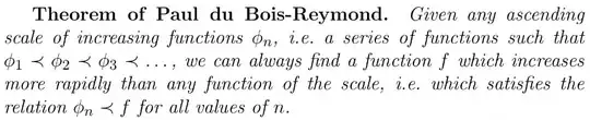

Take a look at Hardy's translation and edition of Du Bois-Reymond's Orders of Infinity, page 10:
