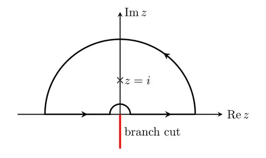

(Using the approach suggested by the OP.) Let $\sqrt{z}$ denote the branch of the complex square root with a branch cut along the negative real axis, and look at the indented semi-circular contour $\Gamma$.
$\newcommand{\Res}{\operatorname{Res}}$
Let $f(z) = \dfrac{\sqrt{z}}{1+z^2}$, and integrate along $\Gamma$.
Since $f$ is bounded near the origin, the integral over the small semi-circle tends to $0$ as the radius tends to $0$, and the integral over the large semi-circle $C_R^+$ tends to $0$ by the standard estimation lemma:
$$ \left| \int_{C_R^+} \frac{\sqrt{z}}{1+z^2}\,dz \right| \le \pi R \cdot \frac{2}{R^{3/2}} $$ for $R$ sufficiently large.
The integral over the positive real axis is exactly what we're looking for, and the integral over the negative real axis will be $$ \int_{-\infty}^0 \frac{i\sqrt{-x}}{1+x^2}\,dx = i\int_0^{\infty} \frac{\sqrt{x}}{1+x^2}\,dx. $$
Summing up, using the residue theorem: $$ \int_0^{\infty} \frac{\sqrt{x}}{1+x^2}\,dx + i\int_0^{\infty} \frac{\sqrt{x}}{1+x^2}\,dx = 2\pi i \Res(f; i) = 2\pi i\,\frac{\sqrt{i}}{2i} = \pi\left( \frac{1}{\sqrt{2}} + \frac{i}{\sqrt2} \right). $$
Taking the real (or imaginary) part of this final equality gives $$ \int_0^{\infty} \frac{\sqrt{x}}{1+x^2}\,dx = \frac{\pi}{\sqrt{2}}.$$

  • I'm trying to compute the same integral using exactly this contour. Let $R$ and $r$ be the radii of the larger and smaller circles, respectively, and $I$ the desired integral. Why is the integral over the negative real axis not$$\int_{-R}^{-r}\frac{i\sqrt x}{x^2+1}\quad?$$My reasoning is that if I parameterize $z=x$ with $-R\le x\le-r$, then $\sqrt z=\sqrt{|z|}e^{i \arg(z)}=i\sqrt x$ (since $\arg(z)=\pi$ for all $z$ on this line segment). This is evidently wrong, but I don't immediately see why... – user170231 May 24 '21 at 19:42
  • I think I see the problem with my reasoning: $\sqrt z=\sqrt{|z|}e^{i\arg(z)/2}=\sqrt{\color{red}{|x|}}e^{i\pi/2}=i\sqrt{-x}$, since $x<0$. – user170231 May 24 '21 at 22:05
