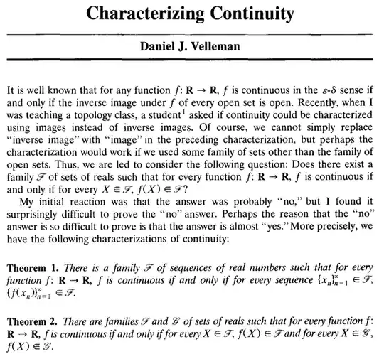

Perhaps the following paper would be of interest to you:
Velleman, D. J. (1997). Characterizing continuity. The American Mathematical Monthly, 104(4), 318-322. Link.
Here is the beginning:
    Looks like the result in that paper has been published (in greater generality) before: https://mathoverflow.net/questions/223708/is-any-function-taking-compact-sets-to-compact-sets-and-connected-sets-to-conne – Daniel McLaury Nov 17 '18 at 02:17
    Theorems 1 and 2 are not the main results of the paper--they are just the motivation. The main result is that the answer to the question at the end of the first paragraph is, indeed, "no". In fact, there do not exists families of sets $\mathcal{F}$ and $\mathcal{G}$ such that a function $f : \mathbb{R} \to \mathbb{R}$ is continuous if and only if for every $X \in \mathcal{F}$, $f(X) \in \mathcal{G}$. – Dan Velleman May 10 '19 at 14:25
