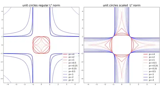

Just as a remark, these are the unit-circles with respect to the $L^p$ norm (not a real norm for $p<1$):
unit circle scaled lp norm
These can be obtained by using polar coordinates $x=r⋅\cosφ$ and $y=r⋅\sinφ$, since then
$$‖(x,y)‖_p = c ⟺ r=\frac{c}{‖(\cosφ,\sinφ)‖_p}$$
If $p→0$, then by the geometric mean formula we get exactly the hyperbola $|xy|=1$. It seems noteworthy that compared to the regular $L^p$-norm, there is a continuous transition to negative $p$-values.
