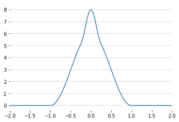

Here's an example of a function whose Fourier transform has a local minima which is not a zero:
$$ f(x) = \begin{cases} 3(1 + \cos \pi x) + (1 + \cos 4 \pi x)& |x| \le 0.25, \\ 3(1 + \cos \pi x) & 0.25 < |x| < 1, \\ 0 & \text{otherwise} \end{cases} $$
Here's a plot of the function:
Plot of the function $f$
and of the absolute value of its Fourier transform:
Plot of the Fourier transform of $f$
