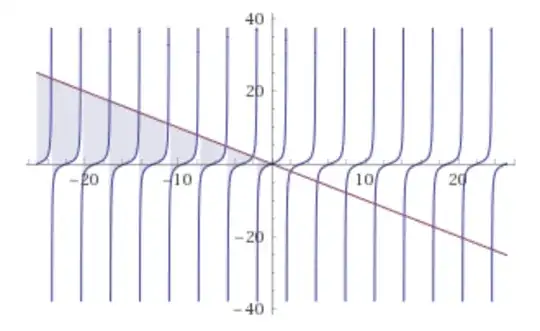

This is not a complete answer, just a summary of notes with a "visualisation" and insights into the problem (which I keep open for a couple of weeks and feel saddened to drop).
Note 1. From Kronecker's approximation theorem $$M=\left\{k\pi+n \mid k,n\in\mathbb{Z}\right\} \tag{1}$$ is dense in $\mathbb{R}$.
Note 2. Function $f(x)=x+\tan{(x)}$ is continuous on $\left(t\pi-\frac{\pi}{2},t\pi+\frac{\pi}{2}\right), \forall t\in\mathbb{Z}$ and has $\mathbb{R}$ as its range (easy to see by checking function's behaviour at $-\frac{\pi}{2}$ and $\frac{\pi}{2}$). Also $$f(-x)=-x+\tan{(-x)}=-x-\tan{(x)}=-f(x)$$
Note 3. It is clear that for $$\forall t_{k,n} \in M: f\left(t_{k,n}\right)=k\pi+n+\tan{(n)} \tag{2}$$ Now let's look at the cases when $f(x)\leq0$ enter image description here Of which, there are plenty for $x\leq0$ and getting pretty scarce for $x>0$.
Note 4. Because $M$ is dense in $\mathbb{R}$ (from Note 1) we can approximate any $x$ satisfying $f(x)\leq0$, e.g. $\left|x-t_{k_x,n_x}\right|<\delta$, and because $f(x)$ is continuous almost everywhere (from Note 2), $f\left(t_{k_x,n_x}\right)$ will approximate $f(x)$, e.g. $\left|f(x)-f\left(t_{k_x,n_x}\right)\right|<\varepsilon$. This means $$\forall x: f(x)\leq 0 \Rightarrow \exists t_{k_x,n_x}\in M: f(t_{k_x,n_x})\leq 0 \overset{(2)}{\Rightarrow} n_x+\tan{(n_x)}\leq-k_x \pi \tag{3}$$
Note 5. So far we established the existence of infinity of $n,k\in \mathbb{Z}$ s.t. $n+\tan{(n)}\leq-k \pi$. Obviously, if we want $n,k\in \mathbb{N}$, from Note 4, $x$ will have to be positive. But, from Note 3, these intervals are becoming pretty scarce, although not empty $$\left(t\pi-\frac{\pi}{2},\alpha_t\right]: \tan{(\alpha_t)}=-\alpha_t$$ and we want $k,n\in\mathbb{N}$ s.t. $$0<\color{red}{t\pi-\frac{\pi}{2}} < k\pi +n \leq \color{red}{\alpha_t}<t\pi \tag{4}$$ $t\in\mathbb{N}$, with the bounds $0\leq n<\pi\left(t-\frac{1}{2}\right)$ and $0\leq k < t-\frac{1}{2}$. It's not too dificult to show that
$$0<\alpha_t- t\pi+\frac{\pi}{2} \rightarrow 0, t \rightarrow \infty \tag{5}$$
From $$(4) \Rightarrow 0<\alpha_t- t\pi+\frac{\pi}{2}<\frac{\pi}{2} \Rightarrow -\frac{\pi}{2} < \alpha_t- t\pi < 0$$ which means $\lim\limits_{t\rightarrow\infty} \alpha_t \rightarrow \infty$ since $\lim\limits_{t\rightarrow\infty} t\pi \rightarrow \infty$. But $$\tan{\left(\alpha_t- t\pi\right)}=\tan{(\alpha_t)}=-\alpha_t \rightarrow -\infty, t \rightarrow \infty$$ which is only possible when $\alpha_t- t\pi \rightarrow -\frac{\pi}{2} \Rightarrow 0<\alpha_t- t\pi+\frac{\pi}{2} \rightarrow 0, t \rightarrow \infty$.
Note 6. In fact (forced by $(5)$), we want $(4)$ as small as possible
$$0<\color{red}{t\pi-\frac{\pi}{2}} < k\pi +n \leq \color{red}{t\pi-\frac{\pi}{2}+\varepsilon} \iff \\ 0<2t\pi-\pi < 2k\pi+2n \leq 2t\pi-\pi+2\varepsilon \\ 0<2t\pi-\pi - 2k\pi < 2n \leq 2t\pi-\pi-2k\pi+2\varepsilon$$ $$\frac{\pi}{2} < \frac{n}{2(t-k)-1} \leq \frac{\pi}{2}+\frac{\varepsilon}{2(t-k)-1} \tag{6}$$ leading to odd denominators and best rational approximations of $\frac{\pi}{2}$ with odd denominators (and even A046965 and Newton/Euler) explored by the other answers.
