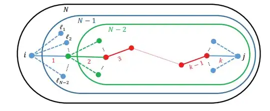

Based on this paper you can think about it as a layer-wise exploration of all the nodes (i.e. nodes in each layer are equidistant from the starting node)
The paper models the distribution of the shortest path $P(d_{ij} = k)$, and provides a recursive formulation for the distribution (and its approximation).
