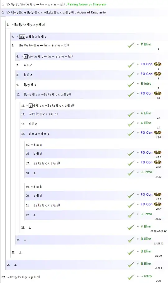

Here is a proof in Fitch ... the FO Con steps are computer-assisted steps but are easily fleshed out into actual formal inference rules. The $c$ introduced on line $6$ is of course the set $\{ a, b \}$ (= $\{ x, y \}$ in your question)

    Please don't insert images of the results generated by a computer program. It's like going to Wolfram to ask for a solution to a specific integral, with step-by-step instructions, copying the image, or a screenshot, and uploading it in an answer post. Here and there, occasionally, I can understand its use. But this program is your go-to for proofs these days. For future users' sake, please explain in more detail what the shorthand justifications stands for. – amWhy Jun 08 '18 at 20:09
