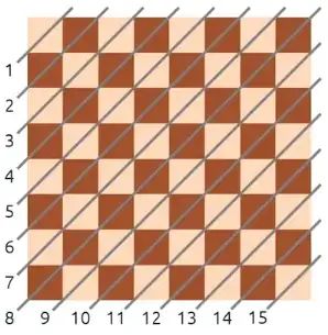

UPDATE: Proof that only 14 bishops can be placed:
If we divide the chessboard into diagonals, and we treat diagonal 1 and 15 as the same diagonal, then the maximum number of bishops per diagonal is 1, therefore 14.
Chessboard diagonals

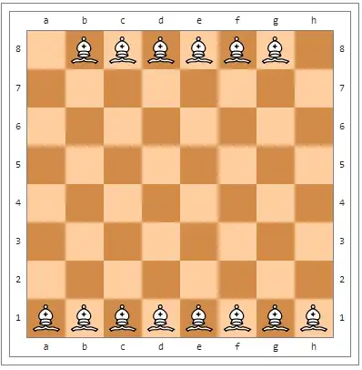

Here is an example configuration of 14 bishops to show it's possible:
14 non-attacking bishops
