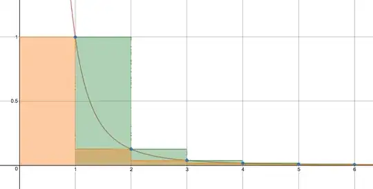

enter image description here See green bars for LH inequality and orange bars for RH inequality. $$\begin{align} 1+\int_2^\infty\frac 1{x^3}\; dx \quad &<\quad \sum_{n=1}^\infty \frac 1{n^3} &&<\quad 1+\frac 18+\int_2^\infty \frac 1{x^3} \; dx\\ \frac 98 \quad &<\quad \sum_{n=1}^\infty \frac 1{n^3} &&<\quad\frac 54 & \end{align}$$
