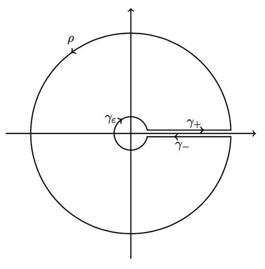

Next, consider the keyhole contour as shown below
where the radius of $\rho$ is $R$, the radius of $\gamma_\epsilon$ is $\epsilon$, and $\gamma_+$ and $\gamma_-$ are respectively just above and just below the positive real axis.
For each $R$ and $\epsilon$, lets call this contour $\Gamma _{R,\epsilon}$.

Now lets have a look at each individual component of $\Gamma_{R,\epsilon}$
$f$ has no singularities inside $\gamma_\epsilon$. However, it does go from one end of the branch cut to the other, so we cannot just claim that its integral is $0$. Instead, we can use the fact that $\epsilon \rightarrow 0$:
\begin{align} \bigg| \int_{\gamma_\epsilon}\frac{x^\alpha}{1+x^n}dx \bigg| & ≤ \int_{t=0}^{t=2\pi}\bigg| \frac{\epsilon^\alpha e^{it\alpha}}{1+\epsilon^n e^{itn}}i\epsilon e^{it} \bigg| dt \\ & = \epsilon^{\alpha+1} \int_{t=0}^{t=2\pi}\bigg| \frac{1}{1+\epsilon^n e^{itn}}\bigg| dt \\ & ≤ \epsilon^{\alpha+1} \int_{t=0}^{t=2\pi} \frac{1}{1-\epsilon^n}dt \\ & = \frac{2\pi \epsilon^{\alpha+1}}{1-\epsilon^n} \rightarrow 0 \quad \text{as} \; \epsilon \rightarrow 0 \end{align}
Hence
$$\lim_{\epsilon \rightarrow 0} \int_{\gamma_\epsilon} f(x)dx=0 \tag{2}$$
Of course, we can use a similar argument for the big arc $\rho _R$
$$\bigg| \int_{\rho_R}\frac{x^\alpha}{1+x^n}dx \bigg| ≤ \int_{t=0}^{t=2\pi}\bigg| \frac{R^\alpha e^{it\alpha}}{1+R^n e^{itn}}iR e^{it} \bigg| dt ≤ \int_{t=0}^{t=2\pi}\frac{R^{\alpha +1}}{1-R^n}dt=\frac{2\pi R^{\alpha +1}}{1-R^n} \rightarrow 0 \; \text{as} \; R\rightarrow \infty$$
where we have used the fact that $\alpha +1<n$. It follows that
$$\lim_{R \rightarrow \infty} \int_{\rho_R} f(x)dx=0 \tag{3}$$
Next, we observe that the integral along $\gamma_+$ is the one we want. As for the integral along $\gamma_-$, we see that it is parameterised in the opposite direction as $\gamma_+$.
Moreover, look back at our definition of $x^\alpha$. If we were to take a point $x_+$ just above the real axis, and its "corresponding point" $x_-$ just below the real axis, we see that
$$x_-^\alpha = |x_-|^\alpha e^{i\alpha (2\pi)}=e^{i\alpha (2\pi)}\bigg(|x_+|^\alpha e^{i\alpha (0)}\bigg)=e^{i\alpha (2\pi)}x_+^\alpha$$
Hence, we have the relationship
$$\int_{\gamma_-}f(x)dx=-e^{i\alpha (2\pi)}\int_{\gamma_+}f(x)dx \tag{4}$$
FINALLY, if we plug $(2)$, $(3)$ and $(4)$ back into $(1)$, we get
\begin{align} & \lim_{R \rightarrow \infty} \lim_{\epsilon \rightarrow 0}\int_{\Gamma_{R,\epsilon}}f(x)dx=2\pi i \Omega \\ \implies & \lim_{R \rightarrow \infty} \lim_{\epsilon \rightarrow 0} \bigg(\int_{\gamma_\epsilon \, +\, \rho_R \,+\, \gamma_+ \,+\, \gamma_-} f(x)dx \bigg) =2\pi i \Omega \\ \implies & (0)+(0)+\lim_{R \rightarrow \infty} \lim_{\epsilon \rightarrow 0} \bigg(\int_{\gamma_+} f(x)dx + \int_{\gamma_+} f(x)dx \bigg)=2\pi i \Omega \\ \implies & \lim_{R \rightarrow \infty} \lim_{\epsilon \rightarrow 0} \big(1-e^{2\pi i \alpha} \big) \int_{\gamma_+}f(x)dx=2\pi i \Omega \\ \implies & \int_0^\infty \frac{x^\alpha}{1+x^n}dx=\frac{2\pi i \Omega}{1-e^{2\pi i \alpha}} \end{align}
