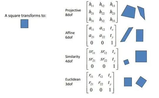

Here is a partial answer, that helps to see the big picture of the classification of (nonsingular) transformations (source, page 12-16):
Note:
  • the "Projective transformation" here is equivalent to the terminology "Homography"
  • "Euclidean" here seems to mean an Euclidean plane isometry. It can be shown that there are four types of Euclidean plane isometries:
    • rotations
    • reflection (mirror with a reflection axis)
    • translations
    • reflection followed by a translation (known as "glide reflection")
