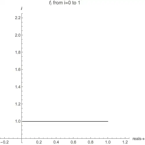

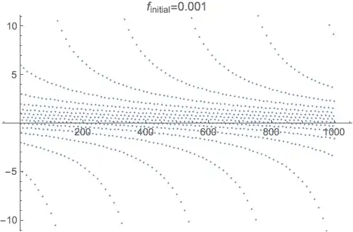

The simple answer is that this repeated fraction isn't convergent for any initial value. Here's a plot of the first thousand iterations of $f_n(x) = 1 - \frac 2 {f_{n-1}(x)}$.

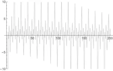

The animation shows how the plot changes for different values of $f_0$. As you can tell, it bounces around a lot. Here's what the first 200 values look like with a line drawn between them (using $f_0=0.001$):
The only stable values of the function are in the complex plane. And even in the complex plane, the function isn't exactly convergent (here the initial value is $f_0=1+i$:
Instead of converging to a single value, the output of the function "orbits" around one of the stable points.
