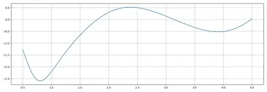

You are to apply the single shooting method.
You already got the first order system
function dotu = model(t,u)
    lambda = 2;
    dotu = [ u(2); lambda*sin(u(1)) ]
end
Now define the shooting function
function omegaL= f(phi0)
    L = 5;
    t,u = ode45(model, [0,L], [phi0,0])
    omegaL = u(end,2)
end
and then call your bisection routine,
phi0 = bisection(f, 1.5, 3.0, 64).
Graph of function $f$, the root inside the given interval is close to $\phi_0=1.80132467093$. This is for a fairly exact integration of the IVP. For the rather inexact Euler method you will get a distorted graph and thus different roots. enter image description here
