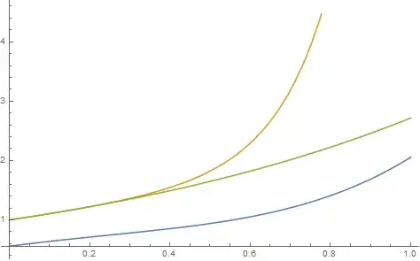

For $n=5$ I got something like:
$f(x)=0.503212 +0.884755 x+0.173988 x^2-0.0557584 x^3+0.17115 x^4+0.249233 x^5-0.159222 x^6-0.317672 x^7+0.172933 x^8+0.0335486 x^9$
...which is pretty bad:
Blue line represents $f(x)$, orange line represents $f(f(x))$ and green line represents $e^x$

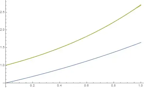

But for $n=20$ I got something "almost" perfect:
$f(x)=-0.00110484 x^{19}+0.00423925 x^{18}-0.00285303 x^{17}-0.00653605 x^{16}+0.00430471 x^{15}+0.0114125 x^{14}-0.00188582 x^{13}-0.0167065 x^{12}-0.00616185 x^{11}+0.0170445 x^{10}+0.0165896 x^9-0.00860714 x^8-0.0207938 x^7-0.00356292 x^6+0.0140354 x^5+0.00731033 x^4+0.0207005 x^3+0.243846 x^2+0.876672 x+0.498799$
...with $\int_0^1f(x)dx=1.02526$

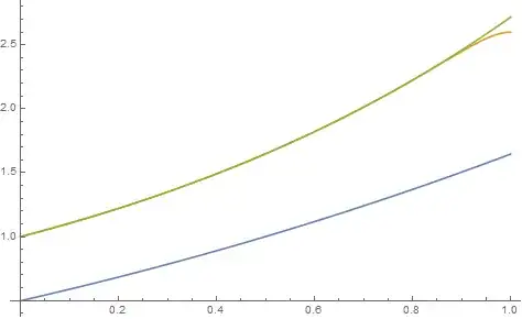

For $n=25$ I did not see much improvement.
I stopped at $n=30$. This is my final result:
$f(x)=3.19108553894\cdot 10^{-6} x^{29}-0.0000320371 x^{28}+0.000102301 x^{27}-0.0000852623 x^{26}-0.000155577 x^{25}+0.000202985 x^{24}+0.0003114 x^{23}-0.000304959 x^{22}-0.000659598 x^{21}+0.00024257 x^{20}+0.00120893 x^{19}+0.000250339 x^{18}-0.00172616 x^{17}-0.00138061 x^{16}+0.00165885 x^{15}+0.00293783 x^{14}-0.000399194 x^{13}-0.00403302 x^{12}-0.00203198 x^{11}+0.00346346 x^{10}+0.00438265 x^9-0.00094675 x^8-0.0047584 x^7-0.00170557 x^6+0.00287885 x^5+0.00131622 x^4+0.0240847 x^3+0.246667 x^2+0.876334 x+0.498618$
...with $\int_0^1f(x)dx=1.02525$
