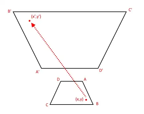

How can I map a trapezoid onto another one with flipped axes. Assuming I know the coordinates of all the points (except $(x\prime,y\prime)$) how can I find $(x\prime,y\prime)$?
The drawing isn't to scale, its just to get my idea across.

If you extend $AB$ and $CD$ until they meet at a point $P$, and do the same for the primed vertices to get a point $P'$, are the angles at $P$ and $P'$ known to be the same? If so, then @gt6989b's solution will work OK. If not, then there's a theorem that says that for any two quadruples of points in the plane, there's a projective transformation taking one to the other.
And if you just want a MAP from one to the other, and don't care whether it's linear, projective, etc., then doing something like a bilinear map is probably your best bet. Finding a bilinear map or projective map between two quadrilaterals is pretty well described in multiple places on the web, so I'm not gonna repeat it here.

  • Finding a bilinear map or projective map between two quadrilaterals is pretty well described in multiple places on the web I'm having trouble finding this. Can you link me to one? – Daffy May 16 '18 at 04:52
  • http://reedbeta.com/blog/quadrilateral-interpolation-part-2/ ; also https://stackoverflow.com/questions/20718663/computing-a-projective-transformation-to-texture-an-arbitrary-quad?utm_medium=organic&utm_source=google_rich_qa&utm_campaign=google_rich_qa ; https://math.stackexchange.com/questions/13404/mapping-irregular-quadrilateral-to-a-rectangle?utm_medium=organic&utm_source=google_rich_qa&utm_campaign=google_rich_qa – John Hughes May 16 '18 at 11:46
Create your transformation in the following steps:
  1. $R$ - rotate the trapezoid $ABCD$ so it becomes oriented the same way as the other one.
  2. $S$ - scale the rotated trapezoid so it becomes the same size as the other one.
  3. $T$ - translate the scaled trapezoid so it coincides with the other one.
Your map then is $f(x) = T(S(R(x)))$ and if you did it correctly, the 4 vertices will map out exactly. Then find your image with the same map.
