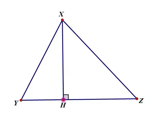

Here's one example of inaccuracy :-
Suppose a triangle $XYZ$ with sides $a=13$, $b=15$ and $c= 14$. We have to find a perpendicular to side $c$ passing from point $X$.
Image Link : https://i.sstatic.net/dmFSL.jpg
According to heron's formulae
$\text{Area} = \sqrt{s(s-a)(s-b)(s-c)}$
$A = \sqrt{21 \times 8 \times 7 \times 6}$
$A = 7 \times 3 \times 4$
$A = 84$
Now
$1/2 × \text{base} × \text{height} = 84$
$1/2 × 14 × h = 84$
$H = \dfrac{84}7$
$H = 12$
But by Pythagoras theorem :-
$H ^2 = P^2 + B^2$
Now let's suppose our expected answer is $d$ then (Refer image above ),
$(a+b)^2 = (2d)^2 + c^2$
$28 ^2 = (2d)^2 + 14^2$
$784 = 4d^2 + 196$
$4d^2 = 784 - 196$
$d^2 = 147$
$d = \sqrt{147}$
Which is not equal to $12$ Which proves inaccuracy

    Keep in mind that Hero of Alexandria died ca. 70 AD. If his formula contained an error, it seems very unlikely that it would have survived until today. See this answer for a nice proof of the formula. Heron's formula suffers from catastrophic cancellation when implemented using finite precision arithmetic. This is an issue when the triangle is shaped like a needle. – Carl Christian May 13 '18 at 17:44
  • The triangle is a 5-12-13 triangle next to a 3-4-5 traingle scaled up to 9-12-15, with the 12 as the common side. – Peter Phipps May 13 '18 at 17:45
    Where did you get $(a+b)^2=4d^2+c^2$? I'm still trying to figure out how you got to that. The sides $a$ and $b$ don't seem like the hypotenuse, which is what I assume you referred as in the formula $H^2=P^2+B^2$ – Frank W May 13 '18 at 17:46
  • $H$ is the height of the $5,12,13$ left side of your triangle and also the height of the $9,12,15$ right side of your triangle. But your $H^2=P^2+B^2$ formula treats $H$ as the hypotenuse of some triangle which does not appear in your diagram. What is this $HPB$ triangle? – John Wayland Bales May 13 '18 at 17:46
  • @JohnWaylandBales I think Ritanshu is using $H^2=P^2+B^2$ as the $\text{hypotenuse}^2=\text{perpendicular}^2+\text{base}^2$ instead of it as points, it would make more sense IMO. But their next step confuses me. – Frank W May 13 '18 at 17:49
Here's what you mean:
You said:
$(a+b)^2=(2d)^2+c^2$
$\Leftrightarrow (XY+XZ)^2=(XH+XH)^2+(HY+HZ)^2$
$\Leftrightarrow XY^2+XZ^2+2XY.XZ=XH^2+XH^2+2XH^2+HY^2+HZ^2+2HY.HZ$
$\Leftrightarrow XY^2+XZ^2+2XY.XZ=(XH^2+HY^2)+(XH^2+HZ^2)+2(XH^2+HY.HZ)$
$\Leftrightarrow XY^2+XZ^2+2XY.XZ=XY^2+XZ^2+2(XH^2+HY.HZ)$
$\Leftrightarrow XY.XZ=XH^2+HY.HZ$
This equality obviously is not true for $XH=12;XY=13;XZ=15;HY=5;HZ=9$, because it is impossible to prove the last equality in general, which means it is false.
user061703
  • 4,027
The inaccuracy is, unfortunately, yours. The step $(a+b)^2=(2d)^2+c^2$ is not a proper way of handling the Pythagorean relations.
If the altitude (of length $d$) separates the base into parts $p$ and $q$, then Pythagoras lets us write $$a^2 = d^2 + p^2 \qquad\text{and}\qquad b^2 = d^2 + q^2 \tag{1}$$ We can use the relation $p+q=c$ to combine these into an equation that allows us to solve for $d$.
Your error, I believe, was in attempting to combine the squared elements in $(1)$, term-by-term: $$(a+b)^2 = (d+d)^2 + (p+q)^2 \qquad(\text{error!})$$ This would be a very convenient algebraic trick, if it worked; but it doesn't. For example, $$5^2=3^2+4^2 \qquad 13^2=5^2+12^2 \qquad\text{but}\qquad \underbrace{(5+13)^2}_{324}\neq\underbrace{(3+5)^2+(4+12)^2}_{320}$$
Instead, we have to work quite a bit harder. We can start by replacing $q$ in $(1)$ with $c-p$: $$\begin{align} b^2 &= d^2 + (c-p)^2 \tag{2}\\ &= d^2 + c^2 + p^2 - 2 c p \tag{3}\\ &= d^2 + c^2+(a^2-d^2) - 2 c p \tag{4}\\ &=a^2 + c^2 - 2 cp \tag{5}\\ 2 cp&= a^2 -b^2 + c^2 \tag{6}\\ 4c^2p^2 &= ( a^2 -b^2 + c^2)^2 \tag{7}\\ 4c^2(a^2-d^2) &= a^4 + b^2 + c^4 - 2 a^2 b^2+2a^2c^2-2b^2c^2 \tag{8} \end{align}$$
For the problem at hand, we can substitute $a=13$, $b=15$, $c=14$ to get $$4\cdot 196 \cdot( 169 - d^2 ) = 19600 \quad\to\quad 169 - d^2 = 25 \quad\to\quad d^2 = 144 \quad\to\quad d = \pm 12$$ where we discard the extraneous negative option. Thus, $d=12$, as expected. $\square$
I could stop here, but I won't. Bear with me as I continue manipulating $(8)$ ...
$$\begin{align} 4a^2c^2-4c^2d^2 &= a^4 + b^2 + c^4 - 2 a^2 b^2-2a^2c^2-2b^2c^2 \tag{9} \\[4pt] -4c^2d^2 &= a^4 + b^2 + c^4 - 2 a^2 b^2-2a^2c^2-2b^2c^2 \tag{10}\\[4pt] 4c^2d^2 &= (a+b+c)(-a+b+c)(a-b+c)(a+b-c) \qquad(\text{trust me}) \tag{11}\\[4pt] \frac14 c^2d^2 &= \frac{1}{16}(a+b+c)(-a+b+c)(a-b+c)(a+b-c) \tag{12}\\[4pt] \left(\frac12 c d\right)^2 &= \frac{a+b+c}{2} \cdot \frac{-a+b+c}{2} \cdot \frac{a-b+c}{2}\cdot \frac{a+b-c}{2} \tag{13} \end{align}$$ Interestingly, if we define $s = (a+b+c)/2$, we have $$s-a = \frac12(a+b+c)-a = \frac12(a+b+c-2a)=\frac{-a+b+c}{2} \tag{14}$$ Also, $$s- b = \frac{a-b+c}{2} \qquad s-c = \frac{a+b-c}{2} \tag{15}$$ Thus, $(13)$ becomes $$\left(\frac12cd\right)^2 = s(s-a)(s-b)(s-c) \tag{16}$$
But $\frac12 cd$ is the area of the triangle! Therefore,
$$\text{area}= \sqrt{s(s-a)(s-b)(s-c)} \tag{$\star$}$$
We have re-proven Heron's formula! $\square$
