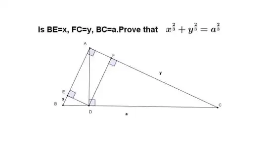

$BE=x, FC=y, BC=a$
Then prove that $x^{2/3}+ y^{2/3}= a^{2/3}$

There's planty of similar triangles there to start working with. Don't you have any progress to share with us? Or do you simply want someone to do your homework for you? – hmakholm left over Monica May 12 '18 at 10:16
I think it need additional construction of circle in which power of point theorem may be use – user9640947 May 12 '18 at 10:19
Basic trigonometry on the many similar right triangles, and some algebra will be enough. Try to express each of $x$ and $y$ in terms of $a$ and the angle at $C$. – hmakholm left over Monica May 12 '18 at 10:25

$$x = |BD|\cos B = |AB|\cos^2 B= a \cos^3 B \qquad\qquad y = a \sin^3 B$$ – Blue May 13 '18 at 03:14

By similar triangles $\triangle CDF,\triangle ABC$ $$\dfrac{CF}{BC}=\dfrac{AE}{AB}\implies\dfrac y{a\sin B}=\dfrac{a\cos B-x}{a\cos B} \iff x\sin B+y\cos B=a\cos B\sin B\ \ \ \ (1)$$
Similarly, by similar triangles $\triangle DAF,\triangle ABC$
$$\dfrac{AF}{CA}=\dfrac{DF}{AB}\implies\dfrac{a\cos B-x}{a\sin B}=\dfrac{a\sin B-y}{a\cos B}\iff x\cos B-y\sin B=a\cos2B\ \ \ \ (2)$$
Solve $(1),(2)$ for $x,y$ to find $x=a\cos^3B,y=a\sin^3B$
Use Prove $\sin^2\theta + \cos^2\theta = 1$
Alternatively, let $AB=c,CA=b\implies a^2=b^2+c^2\ \ \ \ (3)$
by similarities of the triangles we have $$\dfrac y{c-x}=\dfrac bc\ \ \ \ (4)$$ and $$\dfrac{c-x}{b-y}=\dfrac bc\ \ \ \ (5)$$
Solve $(4),(5)$ for $x,y$ and use $(3)$
