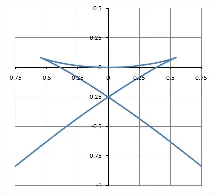

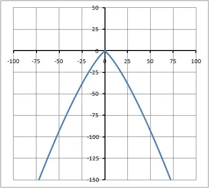

Just drawing the curve parametrically using Excel gives something like large scale curve
but zooming in gives the more interesting enter image description here
largely matching Rahul Narain's answer and Wolfram Alpha
