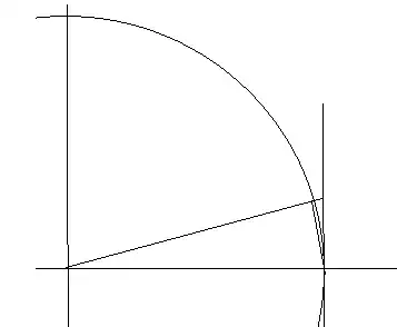

If that it not obvious, consider this figure:
The smaller triangle has area $\frac 12 \sin x$ It sits inside a section of a circle of area $\frac 12 x$ Which in turn sits inside a triangle of area $\frac 12 \tan x$
$1 \le \frac {x}{\sin x} \le \sec x\\ 1 \ge \frac {\sin x}{x} \ge \cos x$
And as $x$ approaches $0,\frac {\sin x}{x} = 1$ by the squeeze theorem.
