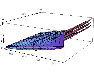

Although I cannot actually give an answer, I have explored many of the avenues for approximation of the sum, which I have illustrated below.
Integral Approximation of the Sum
$$ \int_{0}^{\infty} r^{2^x} \mathrm dx \le \sum_{i=0}^\infty r^{2^i}\le \int_{-1}^{\infty} r^{2^x} \mathrm dx $$
We have: $$ \int r^{2^x} \mathrm dx = \frac{\text{Ei}\left(2^x \log (r)\right)}{\log (2)} $$
For $r < 1$, this converges to $0$ as $x\to\infty$. Therefore, we have the following bounds: $$ -\frac{\text{Ei}\left(\log (r)\right)}{\log (2)} \le \sum_{i=0}^\infty r^{2^i} \le -\frac{\text{Ei}\left(\frac{\log (r)}{2}\right)}{\log (2)} $$
As an example, consider $r = 1/2$. Evaluating the bounds, we have: $ 0.546307 \le 0.816422 \le 1.15583 $. It is clear that this bound may not be entirely the best. However, as $r\to 1$, the bounds are asymptotically equal.
If we do not let $x \to \infty$ and instead consider the general case, we have the following bounds (if we stop at $c$):
$$ \frac{\text{Ei}\left(2^{c+1} \log (r)\right)-\text{Ei}(\log (r))}{\log (2)} \le \Sigma \le \frac{\text{Ei}\left(2^c \log (r)\right)-\text{Ei}\left(\frac{\log (r)}{2}\right)}{\log (2)} $$
Here is a graph of these bounds.
A graph of the bounds given.
