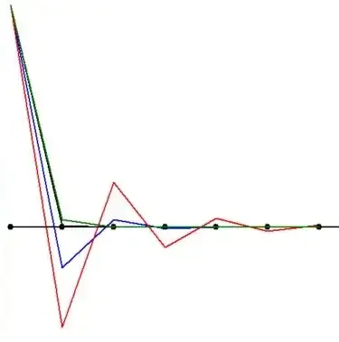

According to one of Patankar's "Four Basic Rules" (at page 37), "the rule of positive coefficients", off-diagonal terms $E_{i,j}$ with $i \ne j$ must be less than zero. With our 1-D problem this means a restriction on the mesh size for common and one-point integration (same colors are employed in the picture below): $$ E_{0,1}^{(i)} = E_{1,0}^{(i)} = -1/(x_{i+1}-x_i)+(x_{i+1}-x_i)\,p^2 \times C < 0 \\ \Longleftrightarrow \quad C\,\left[\,p\,(x_{i+1}-x_i)\,\right]^2 < 1 \quad \mbox{with} \quad C = \begin{cases} \color{blue}{1/6} \\ \color{red}{1/4} \\ \color{green}{0} \end{cases} $$ The above condition becomes increasingly difficult to fulfill when $\,p\,$ is large. The only exception being $\,C=\color{green}{0}$ , which happens to be : integration (points) at the element vertices !
This is seen in the following picture for our constant $p=100$ and number of mesh points $N=20$. Mind the different colors:
Thus we may conclude that the case with $\,\color{red}{C = 1/4}\,$ (i.e. centroid integration) is worst and the case with $\color{green}{C = 0}$ (i.e vertex integration) is best.

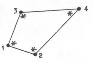

But there is more. Alternative integration schemes in FEM are sort of a stargate for incorporating knowledge from other numerical methods, such as the Finite Volume Method. As is exemplified here for example:
In that answer it has not been mentioned that integration points at a quadrilateral finite element are actually taken at the nodal points, i.e. the vertices, as has been suggested in the OP's question:
Resulting in a splitting of the quadrilateral in four linear triangles:
Finally, these triangles comprise an equivalent finite volume method for the diffusion problem in a finite element context. A much more complete account of this theory is found elsewhere, being too large to fit into the margins of MSE : 2-D Elementary Substructures .
