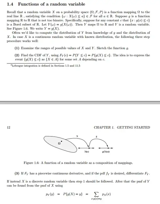

Give Bruce Hajek's notes on Random Processes a try. I found some of the diagrams pretty intuitive and easy to understand even if you are a novice or not. See a snippet from his notes below: enter image description here
