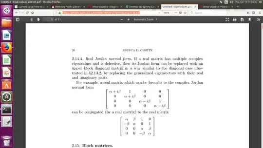

  • @ancientmathematician there is a relevant example on the first page of https://people.math.osu.edu/costin.10/5101/Eigenvalues%20p20-30.pdf It seems this is called the real Canonical Form or the Real Jordan form. I did one yesterday that had all genuine eigenvalues https://math.stackexchange.com/questions/2742114/matrix-in-canonical-form-of-an-orthogonal-transformation/2743574#2743574 This question is similar but needs that business about generalized eigenvectors. On the other hand, the final answer is all nice numbers – Will Jagy Apr 19 '18 at 18:36

I finished this, I think I will revise it to agree with the example in Costin, which is the only image i could find so far that showed what I wanted. First we find the Jordan form with the complex eigenvalues; this involves generalized eigenvectors here. Next, for the two vectors for a fixed eigenvalue (here $i$) for each make a pair of real vectors out of the real and imaginary parts. Just needs care. I need to get groceries and will typeset things later, that will take some real time. Notes at COSTIN
