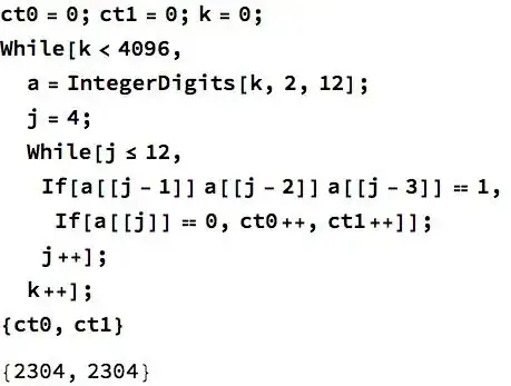

I didn't look at your program, and what it tried to do. In any case your $60\%$ claim made in the text is simply wrong since it contradicts the assumed independence of the digits. (This dream of yours has been the ruin of thousands of gamblers $\ldots$)
If you are not convinced: The following little program looks at all binary strings of length $12$ and counts how often $111$ is followed by a $0$, resp., by a $1$. The resulting numbers are equal.
  • Yes I agree, I did found the same results indeed – Marco Bellocchi Apr 12 '18 at 11:16
