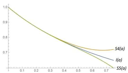

Here's the plot (scaled by $2/\sqrt{\pi}$ for convenience):
A much better approximation would be:
$$I(a) \approx \frac{S_4(a)+S_5(a)}{2}$$
which is a useful general trick for alternating series.
