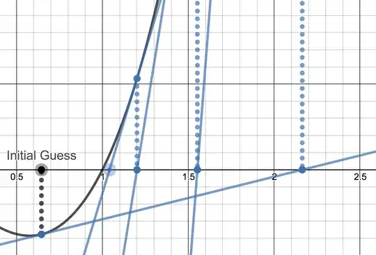

Newton's method is a way of numerically approximating the roots of sufficiently smooth functions (though I'm restricting our attention to only polynomials here). For an example of how the method works, I've put together a little Desmos demonstration for finding a root of the polynomial $f(z) = z(z+1)(z-1)$. By dragging the "Initial Guess" around, you can see how the first couple of iterations begin to approximate roots.

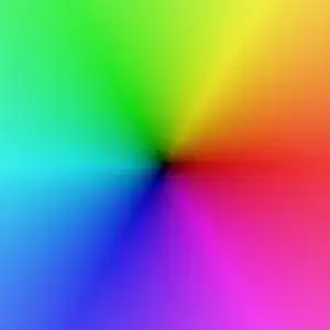

One way to get at this is to attempt to graph the iterations. To do this, start with the complex plane:

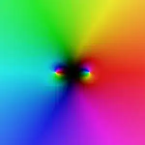

Here, points in the complex plane are assigned a color. Black points are near zero, red points are along the positive real axis, cyan points are along the negative real axis, and so on. To "graph" a function on the complex plane, pick a point, figure out where the function sends that point, and color the original point with the corresponding color from the limit point. For example, if we apply one iteration of Newton's method to the complex plane (for the function $f(z) = z(z+1)(z-1)$), we obtain
Note that points near zero remain near zero, and that numbers of large magnitude don't seem to move very far, but that something interesting is happening near the origin. After 100 more iterations, we get this picture:

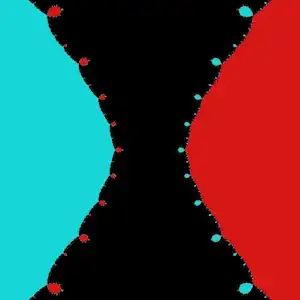

There are basically three colors in this picture: black (corresponding to the point $0$), red (corresponding to the point $1$), and cyan (corresponding to the point $-1$). This picture shows us where a given initial value $z_0$ is sent by Newton's method. Nearly every point in the complex plane is sent to one of the three roots, but observe that there is some chaotic behaviour near the boundary of each basin of attraction (the red region is the basin of attraction for the root $z=1$, as every point in the red region is "attracted to" this root by Newton't method)---there a little blobs of different colors running along these boundaries.
If you played with the Desmos demo, you might have noticed that if you pick an initial guess near $\pm0.5$, the subsequent guesses "bounce around" a lot before they start to settle in towards one of the roots. This is exactly the chaotic behaviour that leads to the little bulbs in the last image above. This detail is the result of a real phenomenon (which you can readily see for yourself by fiddling with the demonstration), and is not due to numerical errors introduced by the computer.
