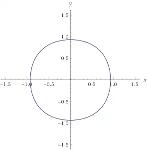

The first curve $x\sinh(x) + y \sinh(y) = 1$

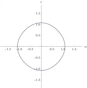

The second curve $u \sinh^{-1}(u) + v \sinh^{-1}(v)=1$ (the dual of the first)
dual curve $u \sinh^{-1}(u) + v \sinh^{-1}(v)=1

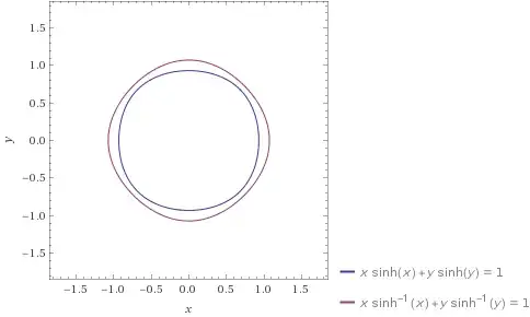

Both curves together:
both curves together

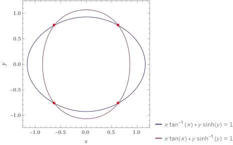

As an example in the latter family that is not an ellipse one may take $f(x)=\tan^{-1}(x), f^{-1}(x)=\tan(x),g(x)=\sinh(x), g^{-1}(x)=\sinh^{-1}(x)$. That is, the curve $x \tan^{-1}(x) + y \sinh(y) = 1$ with dual curve $u \tan(u) + v \sinh^{-1}(v)=1$, shown below.
a more general example

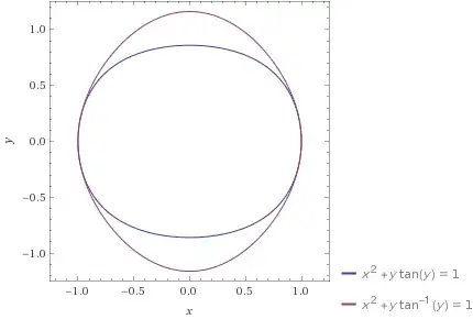

$x^2+y\tan(y)=1$ with dual $u^2+v\arctan(v)=1$, shown below

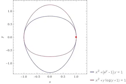

$x^2+y(e^y-1)=1$ with dual $u^2+v\ln(1+v)=1$, shown below
