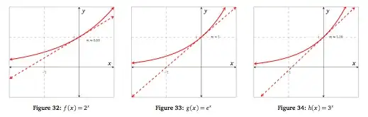

Considering functions of the form $f(x)=a\,b^x$ with $b>0$, we will always have an initial value of $a$. Only with the base $b=e$ will we also have an initial rate-of-change equal to $a$.
Demonstrate this with pictures: 2^x, e^x, and 3^x plotted near x=0, together with initial tangent lines
(This image is from lecture notes I am coauthoring.) Even better would be a GeoGebra applet modeled after images like these where $a$ and $b$ are manipulable.
