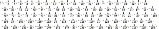

I let do the task by Mathematica, and obtained a surprise:
We see here not a more or less random sequence of positive and negative terms, depending on arithmetic accidents, but a definite pattern: There are blocks of five subsequent terms of the following kind: $${1\over 2n-1}, -{1\over 8n-6}, \ -{1\over 8n-4}, \ -{1\over 8n-2}, \ -{1\over 8n} \qquad(n\geq1)\ .$$ I hope that someone will be able to prove that the sequence will go on forever like that.
Christian Blatter
- 232,144
Yes this works. My previous answer: https://math.stackexchange.com/a/1623739/442 – GEdgar Apr 04 '18 at 11:11
