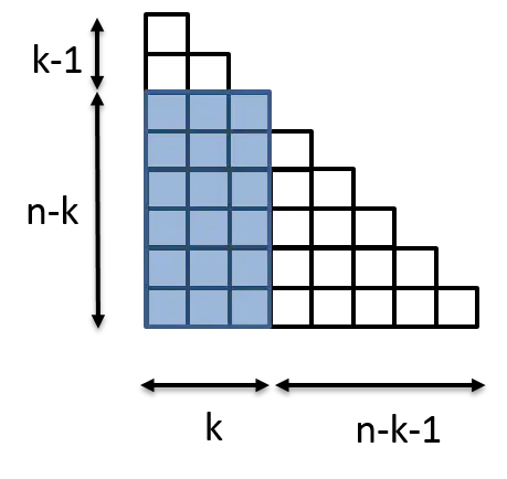

And again, you can prove by strong induction that no matter how you break up the bar, your total score in the end will be $\frac{n(n-1)}{2}$. Here is a proof by picture, knowing that $\frac{n(n-1)}{2}$ is the sum of all numbers $1$ through $n-1$ (i.e. triangular number $T_{n-1}$):
This picture shows that $T_{n-1}=k(n-k)+T_{k-1}+T_{n-k-1}$, so using the inductive hypothesis that the score you get for breaking apart a chunk of chocolate of size smaller than $n$ always gives you a score of $T_{k-1}$, no matter how you break it up, we obtain that the score of breaking the chunk with $n$ pieces gives you $k(n-k)+T_{k-1}+T_{n-k-1}=T_{n-1}$ points, no matter where you place the next break.
