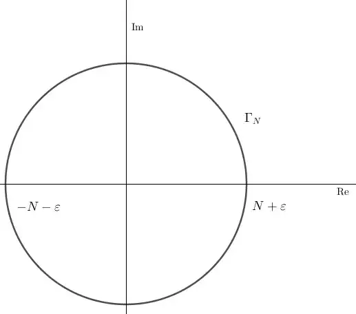

I've got a complex function: $$f(z)=\frac{\pi\cot{\pi z}}{z^2}$$ I want to integrate it around a contour $\Gamma_N$ such that the poles at $$-N,-N+1,-N+2\cdots-1,0,1,\cdots N-2, N-1, N$$ are contained in the contour, so i choose a circle with radius $N+\varepsilon$ where $N\in\Bbb{N}, \varepsilon \in (0,1)$ The contour
My goal is to show that the integral for $N\to\infty$ $$\oint_{\Gamma_N}f(z)dz=0$$ In fact, it must equal to zero because by residue theorem $$\oint_{\Gamma_N}f(z)dz=\operatorname{Res}(f,0)+\sum_{n=-N,n\neq0}^Nn^{-2}$$ the residuum at $0$ is equal to $-\pi^2/3$ and for $N\to\infty$ this solves the basel problem. Returning to the contour integral: $$\oint_{\Gamma_N}f(z)dz=\int_0^{2\pi}f((N+\varepsilon)e^{i\varphi})d(N+\varepsilon)e^{i\varphi}=$$ $$=\int_0^{2\pi}\frac{\pi\cot({\pi(N+\varepsilon)e^{i\varphi})}}{(N+\varepsilon)e^{i\varphi}}id\varphi$$ Now i would prove that the limit as $N\to\infty$ of the integrand goes to zero, namely: $$\mathcal L= \lim_{N\to\infty}\frac{\cot{(\pi(N+\varepsilon))}}{(N+\varepsilon)}=\lim_{N\to\infty}\frac{\cos{(\pi(N+\varepsilon))}}{(N+\varepsilon)\sin{(\pi(N+\varepsilon)})}$$ and the argument is: $$\lim_{N\to\infty}\frac{\cos{(N+\varepsilon)}} {N+\varepsilon}=0$$ by squeeze theorem and $$\sin(\pi(N+\varepsilon))$$ is never equal to zero, because $$(N+\varepsilon)\notin\Bbb{N}$$ This would prove that integrand is zero therefore the contour integral is equal to zero. My question is, is my argument correct? Thanks for any advice.

  • The argument is not valid. You need to show that $\frac{\cot((N+1/2)e^{i\phi})}{(N+1/2)}\to 0$. So, you need to analyze more carefully the behavior of the complex cotangent on the circle. – Mark Viola Apr 03 '18 at 14:45
  • So, i used the definition of cotangent: $$\cot{z}=i\frac{e^{2iz}+1}{e^{2iz}-1}$$ and obtained an integral where the numerator is a fraction of the form $$\frac{e^{2i\pi(N+\varepsilon)\cos{\varphi}}e^{-2\pi(N+\varepsilon)\sin{\varphi}}+1}{e^{2i\pi(N+\varepsilon)\cos{\varphi}}e^{-2\pi(N+\varepsilon)\sin{\varphi}}-1}$$ this entire thing in absolute value, can i now say that the part with $e^{i...}$ doesn't change the value and $$e^{-2\pi...}$$ is bounded and for $N\to\infty$ goes to zero? – Michal Dvořák Apr 03 '18 at 14:55
    Not quite. See THIS ANSWER where I showed that the magnitude of the cotangent function, $|\cot(z)|$ is bounded on the circle $|z|=N+1/2$. – Mark Viola Apr 03 '18 at 15:18
  • This helps, but just one clarification, how did you come to the fact, that... $$|\cot{\pi z}|=\sqrt{\frac{\cosh{2\pi y}+\cos{2\pi x}}{\cosh{2\pi y}-\cos{2\pi x}}}$$ – Michal Dvořák Apr 03 '18 at 15:53
  • Please see the edited answer. – Mark Viola Apr 03 '18 at 16:42
