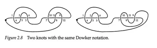

A Dowker-Thistlethwaite code does not necessarily uniquely determine a knot. The counter-example below is from Colin Adams' "The Knot Book." The code $(4, 6, 2, 10 , 12, 8)$ corresponds to the two different knots appearing below. enter image description here
The knots above are composite. You can see this in the DT-code because the first three terms are a shuffling of the set $\{2,4,6\}$ while the last three terms are a shuffling of the set $\{8, 10, 12\}$. When the permutation given by the DT-code can be broken into two two sub-permutations, the knot diagram is composite.

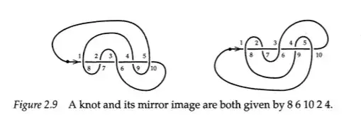

If we restrict to prime knots, then Adams states that the DT-code determines a knot up to mirror images. The code $(8, 6, 10, 2, 4)$ can equivalently describe both the knots below (which are mirror images of one another).
