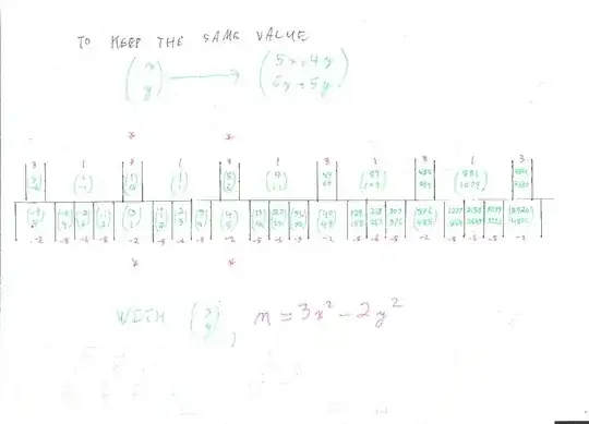

I would expect you to do better with Conway's topograph method. Everything involved here can be done without actual matrices, including the recursion. I guess I will put some books, including a very good new one, CONWAY and HATCHER. There is also (I bought a copy) a well illustrated new one by WEISSMAN
This time it is $$ x_{n+2} = 10 x_{n+1} - x_n \; \; , $$ $$ y_{n+2} = 10 y_{n+1} - y_n \; \; . $$
These come from the combined one-step rule $$ (x_{n+1}, y_{n+1}) = (5 x_n + 4 y_n \; , \; 6 x_n + 5 y_n) $$ which you get pretty quickly with Conway. Here is a fairly basic version of the topograph for $3x^2 - 2 y^2,$ showing several locations with $3 x^2 - y^2 = 1$ labelled with the appropriate $\left( \begin{array}{c} x \\ y \end{array} \right)$ in green
