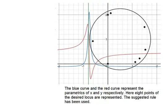

1) Calculate several points $(x, y)$ giving values to the parameter $a$.
2) With luck, the points obtained could configure the required curve.
3) In this case, the points obtained suggest a circumference.
4) Solve a system of three unknowns $h, k, r$ from $(x-h)^2+(y-k)^2=r^2$
We calculate eight points. $$\begin{array}{|c|c|}\hline a&-0.95&-0.9&-0.85&-0.8&-0.755&-0.75&-0.7&-0.5\\\hline f(a)&1.120622&1.297297&1.534246&1.5&0.168804&0&-0.615384&0\\\hline g(a)&0.070038&0.216216&0.575342&1.5&2.067852&2&0.923076&0\\\hline\end{array}$$
We have the following figure:
Important note here.- The black circle in the figure is the solution given by @amd and the non-drawn circle to which the points found belong are different, then one of the two answers is wrong. Probably mine although, even with a computer, one can make mistakes in the use of the Silvester method ....
