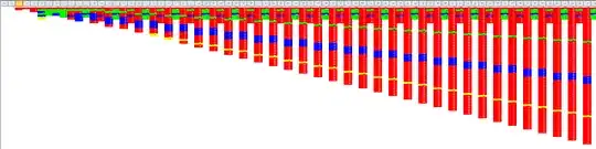

I filled the excel sheets with differences $\{n_1,n_2-n_1,n_3-n_2,\dots,n_i-n_{i-1}\}$ of solution indexes $\{n_1,\dots,n_i\}$ for cases $(d,b)$ where different columns represent different bases $b$ in order, filled with solutions in order, where $d$ is fixed per excel sheet. Then within each column, color the same values with the same color.
Case $d=1$ sheet can be seen below:
Where we can pick every second column, and sort the data (number bases) in two cases:
Notice that the first case has fixed amount of solutions per base, and alternates between "red" and "green" types of solutions. These are easy to calculate/predict for the $n^{\text{th}}$ column. The second case is also easy to predict for the arbitrary column/base as all red values follow one polynomial equation, all greens the second, all blue solutions a third, and all yellows a fourth.
Now we see that we do not need to check every palindrome for $d=1$ cases, but can directly obtain desired solutions following these simple patterns.

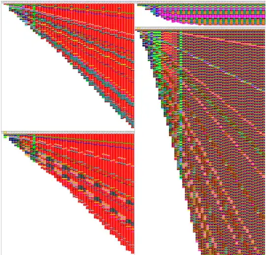

Similarly, for $d=2$ we have established a pattern (more detailed than previous case) that can be split up in four cases by taking every fourth number base:
Again, same colored values can be described by same polynomials, which can be extracted from the data. As you can see, we have one finite-column pattern, two patterns similar to the previous case of $d$, and one very long pattern - which are all fully predictable at this point.

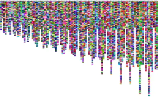

It seems that patterns for every next cases of $d$ are more detailed cases of the previous case. But I have no idea how to generalize this to all $d$, thus I'm trying to compute more data for $d=3$ and $d=4$ at the moment, where $d\ge5$ is simply unreachable because of the absurd number of palindromes and cases that would need to be computed.
Here is a part of $d=3$ data so far, visualized:
This case can be split in six separate pattern cases (by taking every sixth column), if I'm not mistaken so far as I've observed only one of the predicted six clearly, so far. I expect these will become fully clear after some more data is computed. But I do not see how to extend these so far to next $d$ cases.
Full patterns for $d\ge5$ are computationally out of reach by my current methods, and for $d=4$ will take time and patience at best, if I'm not underestimating them.
