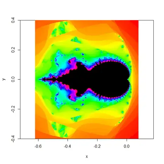

Here's what your suggested example looks like
Here's how I coded it in R:
xmin<--0.62
xmax<-0.08
ymin<--0.4
ymax<-0.4
res<-500
x<-xmin+(xmax-xmin)*ppoints(res)
y<-ymin+(ymax-ymin)*ppoints(res)
comb<-function(x,y) complex(real=x,imaginary=y)
i<-comb(0,1)
z<-outer(x,y,comb)
w<-z/2
c<-z
h<-matrix(rep(2,res^2),res,res)
count<-h
for (k in 1:50) { temp<-w; w[Mod(z)<=2]<-z[Mod(z)<=2]^2+w[Mod(z)<=2]+c[Mod(z)<=2]; z<-temp; count[Mod(z)<=2]<-count[Mod(z)<=2]+1 }
z[Mod(z)<=2]<-h[Mod(z)<=2]
image(x,y,count-log(log(Mod(z))/log(2)),col=c(rainbow(250),'black'),asp=1)
You can play around with it. R is a free program.
