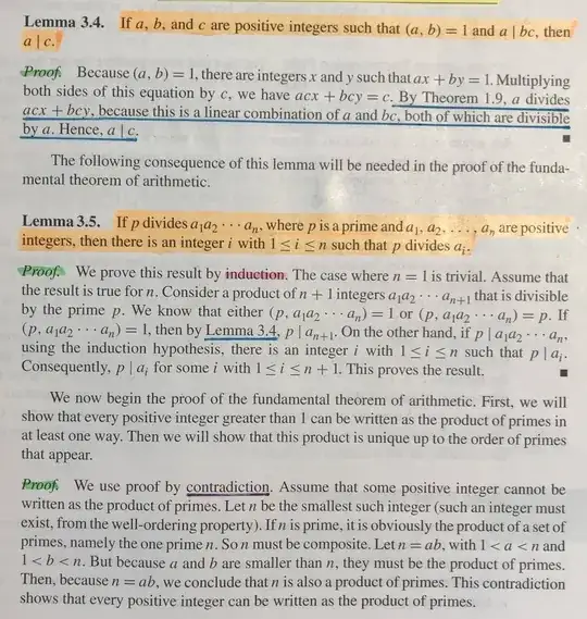

I'm reading the proof of the fundamental theorem of arithmetic in my textbook.
The proof is a proof by contradiction and is easy to follow, but they say that there are two lemma's (Lemma 3.4 and Lemma 3.5) needed to proof the fundamental theorem of arithmetic.
I do understand all the proofs, but I do not understand in which step of the proof of the fundamental theorem of arithmetic we need lemma 3.4 and lemma 3.5.
Can someone explain that to me?
Screenshot of the proof in my tekstbook:

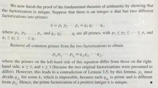

Lemma 3.4 is used to prove lemma 3.5. Lemma 3.5 is used to prove the uniqueness of the Fundamental Theorem of Arithmetic. There $$\prod_{r=1}^u p_{i_r}=\prod_{a=1}^v q_{j_a}$$. Here , say $p_{i_k},1\leq k\leq u$. Then, $p_{i_k}|\prod_{a=1}^v q_{j_a}\Rightarrow p_{i_k}|q_{j_l}$, for some $l, 1\leq l \leq v$, becuse of lemma 3.5. Sincce both are primes then they must be equal.
