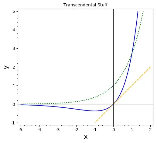

graph of y=x,y=e^x,and y=x*e^x
SageMath source to generate plot
xs = (x,-5,2) ys = (y,-1,5) p1 = implicit_plot(x*exp(x)-y,xs,ys, color='blue', legend_label='y=x*e^x') p2 = implicit_plot(x-y,xs,ys, color='orange', linestyle='dashed', legend_label='y=x') p3 = implicit_plot(exp(x)-y,xs,ys, color='green', linestyle='dotted', legend_label='y=e^x') combined = p1 + p2 + p3 combined.axes_labels(['x', 'y']) combined.legend(True) combined.show(title='Transcendental Stuff', frame=True, axes=True, legend_loc='lower right')

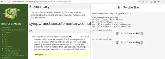

You may run solve(x*exp(x)-y,x) on SymPy Live as an alternative to SageMath.
screenshot of sympy

  • Hmm, solve(x*exp(x)-y,x) --> Traceback (most recent call last):...line 1055, in solve solution = _solve_system(f, symbols, **flags) ... line 158, in _lambert solns[i] = tmp.subs(u, rhs) AttributeError: 'dict' object has no attribute 'subs' I may need to go read & learn about SymPy to figure out what's wrong. (I think SageMath uses SymPy though, so in theory I should be able to access all of the same functionality through that.) – jacobq Mar 21 '18 at 18:25
  • @iX3 I've [edit]ed my post in response to your comment. – GNUSupporter 8964民主女神 地下教會 Mar 21 '18 at 18:33
  • It seems to work now. I'm not sure what was wrong before. Thanks for updating and showing me SymPy – jacobq Mar 21 '18 at 20:39
  • @iX3 You aren't the only one who ran into this error on the homepage of SymPy Live, me too. I don't know why the online shell worked. You're welcome. – GNUSupporter 8964民主女神 地下教會 Mar 21 '18 at 20:46
