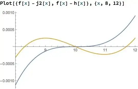

But, depending on your purpose, there are other polynomials of degree $\leq2$ approximating $f$ very well in the neighborhood of $x=10$, e.g. the polynomial $$h(x):=1.71446 + 0.205225 x - 0.00302609 x^2\ .$$ The following figure shows that that the maximal errror of $h$ in the $x$-interval $[8,12]$ is much smaller than the error of $j_2$.
