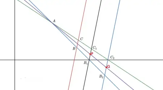

1) Draw two parallels $B_1C_1$ and $B_2C_2$ to the line $BC: 5x-y=7$, for example $y=5x-10$ and $y=5x-\dfrac{25}{2}$.
2) calculate the intersections of $B_1C_1$ with the lines $AB$ and $AC$ and do the same with the line $B_2C_2$ so you get four points $B_1,C_1,B_2,C_2$
3) You have now two points of the required median which are $P=\dfrac{B_1+C_1}{2}$ and $Q=\dfrac{B_2+C_2}{2}$
Calculation gives $$B_1=(2,0),C_1=(\dfrac{35}{17},\dfrac{5}{17}),B_2=(\dfrac{29}{12},\dfrac{-5}{12}),C_2=(\dfrac52,0)\\P=(\frac{69}{34},\frac{5}{34}),Q=(\frac{59}{24},\frac{-5}{24})$$ Thus the equation $$\color{red}{29x+35y=64}$$
