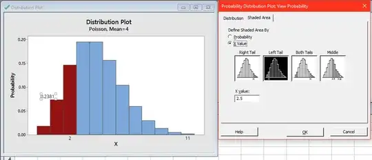

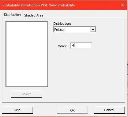

What I think should be done.. P(X≤2.5)= 0.2381 as calculated in my minitab software. However this is incorrect apparently.. :(
What am I doing wrong?
