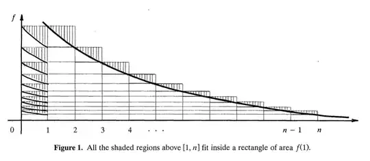

In Tom Apostol's expository article (here's a free link), upon seeing the figure below (or this from the Wolfram project) I was expecting more diagrams to come to continue the error decomposition of the shaded regions in the shape of "curved triangular pieces".
For each horizontal unit interval, it seems that the hypotenuse of an implicit triangle (within shaded region) is the linear correction. Then, there's a "cap" that fills in the gap between the hypotenuse and the actual curve. In this figure, each cap is attached to the implicit hypotenuse from below due to the curve being convex.
It was a disappointment not seeing further decomposition of the "cap" into regions described by parabolic, cubic, then quartic curves etc. Somehow none of the textbooks and other materials I've read have such diagrams for higher orders.

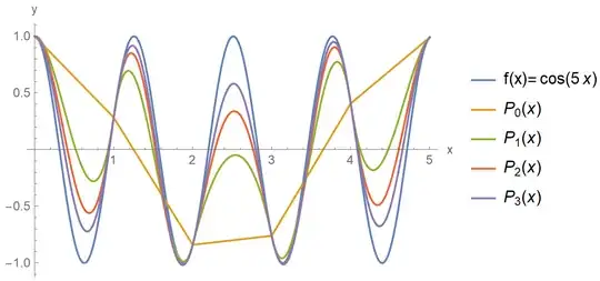

Let’s think were going to approximate $\int_0^1 f(x) \, dx $ in a certain way, then the integral we want to approximate can be expressed as below, then can be approximated. $$ ∫_a^b f(x) \, dx = \sum_{k=a}^{b-1} { \int_k^{k+1} f(x) \, dx} = \sum_{k=a}^{b-1} {\int_0^1 f(x+k) \, dx} $$ Now, we’re going to set a polynomial $p_n (x)$ which has degree lower or equal than $2n+1$ that satisfies $$ p_n(0) = f(0) , \; p_n(1) = f(1) , \; p^{(2 j - 1)}_n(0) = f^{(2j-1)}(0) , \; p^{(2j-1)}_n(1) = f^{(2j-1)}(1) \quad (j = 1,2,\cdots n) $$ When $n=0$, which means there are no derivative conditions, $p_0(x)$ simply becomes a line that connects $(0,f(0))$ and $(1,f(1))$. Roughly speaking, as $n$ increases, even though we’re not using derivatives of even orders, $p_n(x)$ would look more similar with $f(x)$ in $[0,1]$ since $p_n(x)$ is unique and $f(x)$ can be considered as a infinite degree polynomial by taylor expansion, that satisfies all the condition $p_n(x)$ has to satisfy. Being a bit more rigorous knowing the result, if the remainder term of the Euler-Maclaurin formula for $f(x)$ in $[0,1]$ goes to $0$, $p_n(x)$ would converge to $f(x)$.
Beyond topic, the unique existence of this polynomial $p_n(x)$ can be prooved. There are $2n+2$ conditions, and the number of coefficients in a polynomial of degree lower or equal to $2n+1$ is $2n+2$, and the equations for the coefficients would be a linear problem. $(2n+2) \times (2n+2)$ matrix of this linear problem can't have linearly dependent rows because then it would generate a general relation between $g(0),g(1),g'(0),g'(1),\cdots g^{(2n-1)}(0),g^{(2n-1)}(1)$ that works for all $g(x)$, polynomial of degree lower or equal than $2n+1$.
Now we simply approximate as below, expressing error as $R_n$. $$ \int_0^1 f(x) \, dx = \int_0^1 p_n (x) \, dx + R_n, \quad R_n =: \int_0^1 \left(f(x) - p_n (x) \right) \, dx $$ The proof that this approximation gives the Euler-Maclaurin formula can be prooved by itself, the Euler-Maclaurin formula. Since $\deg( p_n (x)) \leq 2n+1 $, derivatives of order larger than $2n+1$ will be $0$. Also, derivate of order $2n+1$ would be a constant. Therefore, $$ \begin{split} \int_0^1 p_n (x) \, dx &= \frac{p_n(0)+p_n(1)}{2} - \sum_{j=1}^{n}{ \frac{B_{2j}}{(2j)!} \left( p^{(2j-1)}_n(1)-p^{(2j-1)}_n(0) \right)} \\ &= \frac{f(0)+f(1)}{2} - \sum_{j=1}^{n}{ \frac{B_{2j}}{(2j)!} \left( f^{(2j-1)}(1)-f^{(2j-1)}(0) \right)} \end{split} $$ Now, let’s use $f(x+k)$ instead of $f(x)$, and say the approximated polynomial is $p_{n,k} (x)$, and the error term is $R_{n,k}$. After telescoping, we can get the Euler-Maclaurin formula written for approximating the integral. $$ \begin{split} \int_a^b f(x) \, dx &= \sum_{k=a}^{b-1} \left( \int_0^1 p_{n,k}(x) \, dx + R_{n,k} \right) \\ &= \sum_{k=a}^b f(k) - \frac{f(a)+f(b)}{2} - \sum_{j=1}^{n}{ \frac{B_{2j}}{(2j)!} \left( f^{(2j-1)}(b)-f^{(2j-1)}(a) \right)} + \sum_{k=a}^{b-1} R_{n,k} \end{split} $$ You can easily see how this can be changed to a geometrical representation of the Euler-Maclurin formula. Simpily draw a function $P_n(x)$, which is $p_{n,k}(x-k)$ for $x \in [k,k+1]$ for $k=a,a+1,\cdots b-1 $, and the Euler-Maclurin formula now means that $\int_a^b f(x) \, dx$ can be approximated to $\int_a^b P_n(x) dx$.
The reason for not using the derivative of even orders can be explained intuitively. When we are summing, telescoping should work and cancel out terms so only the derivatives at $x=a$ or $x=b$ are used. But when you think about the relation of $\int_0^1 f(x) \, dx$ and the value $f^{(k)} (0)$, $f^{(k)}(1)$, you can see that when $k$ is even, $f^{(k)}(0)$ or $f^{(k)}(1)$ increasing would lead $\int_0^1 f(x)\, dx$ increase, and it won’t be able to do telescoping. On the other hand, when $k$ is odd, $f^{(k)}(0)$ increasing or $f^{(k)}(1)$ decreasing would lead $\int_0^1 f(x)\, dx$ increase and the possiblity of telescoping is alive.
This is a picture of visualization for $f(x)=\cos(5x)$. You can see that as $n$ increases, $P_n(x)$ gets close to $f(x)$.
Graph of <span class=$P_0(x), P_1(x), P_2(x), P_3(x)$ for $f(x)=\cos(5x)$" />

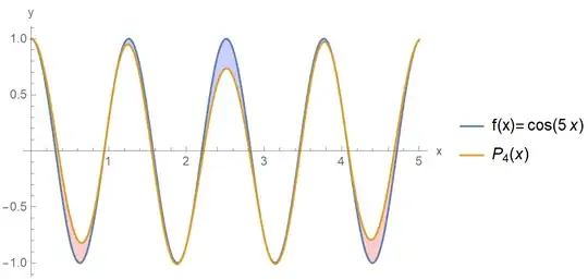

And this a picture that visualizes the error for $n=4$, positive area is red and negative area is blue.
Error for <span class=$n=4$, $f(x)=\cos(5x)$" />

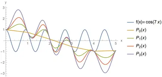

As I mentioned earlier, $P_n(x)$ can diverge if the remainder term of the Euler-Maclaurin formula diverges. You can check this by an example, $f(x)=\cos(7x)$. The graph is in below.
Graph of <span class=$P_0(x), P_1(x), P_2(x), P_3(x)$ for $f(x)=\cos(7x)$" />
