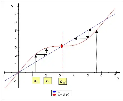

33
So the sequence is $$ \begin{cases} x_{0} = c & \\ x_{n} = x_{n - 1} + \sin (x_{n - 1} ) & \end{cases} $$
and this is what is going to happen. sin@sin-2
The sketch shows that for $0< x_0 < 2\pi$ the recurrence will lead to $\pi$,
for $2\pi< x_0 < 4\pi$ it will lead to $3\pi$, etc.
That means that, among all the solutions $x=n\pi$ to $x=x+\sin(x)$, the actual attractor points are those at $(2n+1)\pi$, while the $2n\pi$ points are unstable.
G Cab
  • 35,964
  • Is this why when I run the function with 100 it returns $\approx 97.3893722612$? – Corpus Shmorpus Mar 08 '18 at 00:57
  • @Coderboy: yes $$ \eqalign{ & x_{,0} = 100\quad \Rightarrow \quad \left\lfloor {{{100} \over {2\pi }}} \right\rfloor = 15,\quad 100\bmod \left( {2\pi } \right) \approx 0.9\quad \Rightarrow \cr & \Rightarrow \quad x_{,\infty } = 31;\pi \approx 97.38 \cr} $$ – G Cab Mar 08 '18 at 01:08
  • so that means 100 falls between $30\pi$ and $32\pi$? I'm very intrigued. – Corpus Shmorpus Mar 08 '18 at 01:09
    exactly, but shall be strictly greater or lower: if you start with precisely $30\pi$ you will remain there (theoretically, numerically the computation error might you drift around or out). – G Cab Mar 08 '18 at 01:14
  • I know that that is true because when I call the int.binary() method from the integer class in python it doesn't equal what I intend it to when doing math things. Basically, computers suck at doing math with decimals – Corpus Shmorpus Mar 08 '18 at 01:17
  • @Coderboy: yes computers are very powerful, but can be tremendously misleading if not "handled" with much care! – G Cab Mar 08 '18 at 01:22
  • @Coderboy: considering previous comment, it would be interesting to know which is the minimum number of iterations required to get a given accuracy. – G Cab Mar 08 '18 at 01:42
  • @G Cab to get 50 decimal places matching the given value of PI, you need 5 iterations – Corpus Shmorpus Mar 08 '18 at 01:44
    @Coderboy The reason for the fast convergence to $x_\infty=31\pi$ that you observed, is that, when $x\to x_\infty$, $f(x)-x_\infty\sim\frac16(x-x_\infty)^3$. Hence, after a while, the number of correct decimals is (roughly) multiplied by $3$ at each iteration. – Did Mar 08 '18 at 06:52
  • @Did: thanks , I was curious to know an estimate of convergence speed – G Cab Mar 08 '18 at 09:34

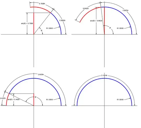

10
It seems the OP has a hard time understanding the answers referring to fixed point iterations - I do too. Here follows a more intuitive and practical way to visualise what OP's formula is doing is by using the arc length of the arcs on the unit circle.
Your angle measured in radians is equal to the arc length of a segment of that angle - let's call it $ø$.
$sin(ø)$ gives you the y-coordinate (distance from the x-axis) of the end of that arc with it's centre at the origin.
In your next step you are creating a new arc by lengthening your arc by $sin(ø)$ and then you measure the distance from the x-axis for the end of your new arc and you keep repeating this procedure.
The measured distance from the x-axis will always be smaller than the length needed to lengthen your arc to $π$ but it keeps getting closer.
The illustration below explains it graphically and it's also easy to see from this why it converges so quickly:
Edit:
The arc length of the remainder of the half circle not covered by your arc is $π-ø$. By inspection, you can prove that $sin(ø)$ will always be smaller than that arc length (except when $ø=π$), thus, continuously adding $sin(ø)$ and adjusting ø to this new value will never exceed $π$.
Similarly you can see that for any value less than $π$, the result will increase, until you reach pi (which will happen at infinity).
