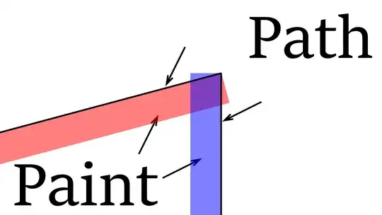

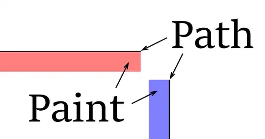

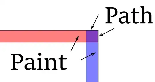

but on the other hand, you can't paint it's sides (infinite perimeter×thickness=infinite surface area)... What am I getting wrong?
The assumption behind this formula is that painting the edges of some form means replacing each edge by a rectangle.
(One edge length of each rectangle is the "thickness" of the pen and the other edge length is the length of the edge which is replaced by the rectangle.)
However this assumption is not correct because at the corners of the original form the rectangles would overlap when painting like this.
To calculate the real area of the "painted edge" you first have to define how the corners of the form are painted. This image from the manual of a graphics program shows different examples how this can be done. And it is obvious that the "painted" area will be different in the three cases shown in the manual.
