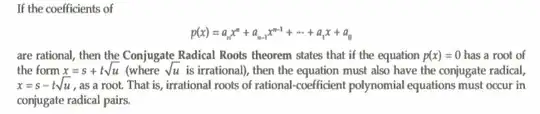

Here, what are exactly $s$. $t$ and $u$? Are they rational numbers with $u$ being nonnegative? There is no exact explanation of the theorem. So I am confused..
Keith
  • 8,359
  • Yes, rational numbers. – Billy Feb 27 '18 at 15:47
  • Does $u$ necessarily have to be nonnegative? – Keith Feb 27 '18 at 15:48
  • I think the statement of the theorem ("$\sqrt{u}$ is irrational") means that it wants you to interpret it that way. But, actually, this theorem does still hold even when u is negative. (The proof they give might not, though!) – Billy Feb 27 '18 at 15:50
  • Thanks for asking this question! I see that you have a number of responses, so please upvote (by pressing the up arrow) any answers that you found helpful. If you feel like your question has been answered, please press the checkmark to accept the answer that best answers your question. – Stella Biderman Feb 27 '18 at 16:55
  • The last sentence in the text is FALSE. It is true that IF $s+t\sqrt u; $ is a root , with$ s,t,u\in \Bbb Q$ where $ u$ is not the square of a rational THEN $s-t\sqrt u;$ is also a root. But it is NOT true that there must be a root that can be expressed in radicals over $\Bbb Q.$ That is , it can happen that all applications of the operations $+,-,\times,$ and $n$th powers (for $n\in \Bbb Z$) and $n$th roots (for $n\in \Bbb N) $ ( including any complex-valued $n$th roots), applied to members of $\Bbb Q,$ will fail to produce a root of $p.$ – DanielWainfleet Feb 27 '18 at 19:11
