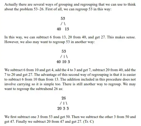

I highly recommend that you read chapter 1 of Liping Ma's Knowing and Teaching Elementary Mathematics – Teachers' Understanding of Fundamental Mathematics in China and the United States, which is about how subtraction is taught in the US and China. Here is a Chinese teacher's discussion of the problem $53-26$ from this chapter (p. 10):
Liping Ma, p. 10
Here is a Chinese teacher's discussion of how she teaches subtraction (p. 11-12):
We start with the problems of a two-digit number minus a one-digit number, such as $34-6$. I put the problem on the board and ask students to solve the problem on their own, either with bundles of sticks or other learning aids, or even with nothing, just thinking. After a few minutes, they finish. I have them report to the class what they did. They might report a variety of ways. One student might say "$34-6$, $4$ is not enough to subtract $6$. But I can take of $4$ first, get $30$. Then I still need to take $2$ off. Because $6=4+2$. I subtract $2$ from $30$ and get $28$. So, my way is $34-6=34-4-2=30-2=28$." Another student who worked with sticks might say, "When I saw that I did not have enough separate sticks, I broke one bundle. I got $10$ sticks and I put $6$ of them away. There were $4$ left. I put the $4$ sticks with the original $4$ sticks together and got $8$. I still have another two bundles of $10$s, putting the sticks left all together I had $28$." Some students, usually fewer than the first two kinds, might report, "The two ways they used are fine, but I have another way to solve the problem. We have learned how to compute $14-8$, $14-9$, why don't we use that knowledge. So, in my mind I computed the problem in a simple way. I regrouped $34$ into $20$ and $14$. Then I subtracted $6$ from $14$ and got $8$. Of course I did not forget the $20$, so I got $28$." I put all the ways students reported on the board and label them with numbers, the first way, the second way, etc. Then I invite students to compare: Which way do you think is the easiest? Which way do you think is most reasonable? Sometimes they don't agree with each other. Sometimes they don't agree that the standard way I am to teach is the easiest way. Especially for those who are not proficient and comfortable with problems of subtraction within $20$, such as $13-7$, $15-8$, etc., then tend to think that the standard way is more difficult.
There's more great stuff in this chapter, but this is a good sample. You can read it for the rest.
