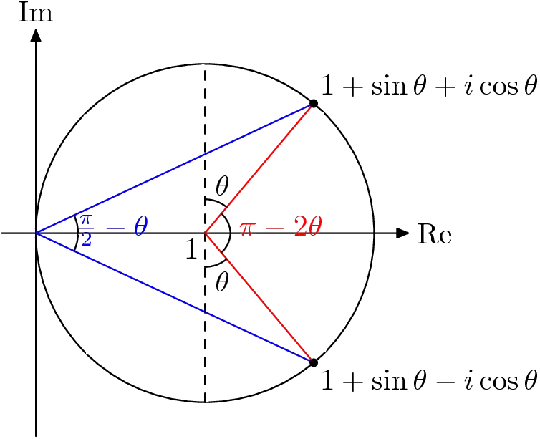

\begin{align*} \left(\frac{1+\sin\theta + i \cos\theta}{1 + \sin\theta -i\cos \theta}\right)^n&=\left(\cos\left(\frac{\pi}{2}-\theta\right)+i\sin\left(\frac{\pi}{2}-\theta\right)\right)^n \end{align*}
