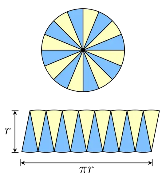

If you take on blind faith that the area of a circle with radius 1 is $\pi$, then you can calculate $\pi$ without trigonometry by taking the power series of $2\sqrt{1 - x^2}$ and integrating it from -1 to 1. The problem is any proof from first principles that the area of a circle with radius 1 is $\pi$ uses trigonometry. First I will calculate $\pi$ directly from its technical definition without using the assumption that the area of a circle with radius 1 is $\pi$. Next, I will prove from first principles that the area of a circle with radius 1 is $\pi$. I don't consider this image a proof from first principles that the area of a circle with radius 1 is $\pi$.

Here's a proof that the area of a circle with radius 1 is $\pi$.
Using the substitution rule in reverse, we get $\int_{-1}^12\sqrt{1 - x^2} = 2\int_{-1}^1\sqrt{1 - x^2} = 2\int_{-1}^1\cos(\sin^{-1}(x)) = 2\int_{\sin(-\frac{\pi}{2})}^{\sin(\frac{\pi}{2})}\cos(\sin^{-1}(x)) = 2\int_{-\frac{\pi}{2}}^{\frac{\pi}{2}}\cos(\sin^{-1}(\sin(\sin'(x)))) = 2\int_{-\frac{\pi}{2}}^{\frac{\pi}{2}}\cos^2(x) = 2\int_{-\frac{\pi}{2}}^{\frac{\pi}{2}}\frac{\cos(2x) + 1}{2} = \pi$
Image source: Area of a circle $\pi r^2$
